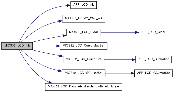

s32 MIOS32_LCD_Init ( u32  mode  )
Initializes LCD driver
Parameters:
[in] mode currently only mode 0 supported
Returns:
< 0 if initialisation failed

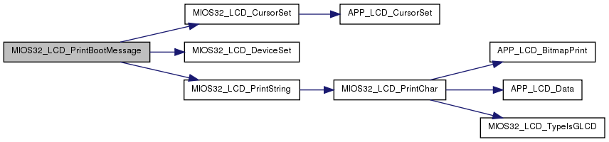

s32 MIOS32_LCD_PrintBootMessage ( void   )
Used during startup to print the boot message, which consists of two lines specified with MIOS32_LCD_BOOT_MSG_LINE1 and MIOS32_LCD_BOOT_MSG_LINE2.
Both lines should be adapted in the mios32_config.h file of an application.
The message is automatically print by the programming model after each reset.
It will also be returned on a SysEx query.
Returns:
< 0 on errors

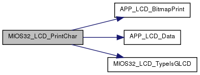

s32 MIOS32_LCD_PrintChar ( char  c  )
Prints a single character
Parameters:
[in] c character to be print
Returns:
< 0 on errors

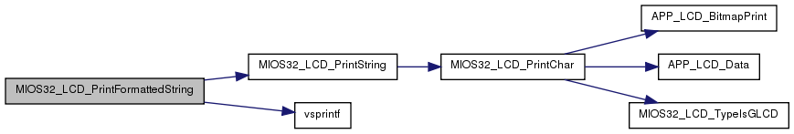

s32 MIOS32_LCD_PrintFormattedString ( const char *  format,
Prints a \0 (zero) terminated formatted string (like printf)
Parameters:
[in] *format zero-terminated format string - 64 characters supported maximum!
... additional arguments
Returns:
< 0 on errors

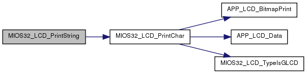

s32 MIOS32_LCD_PrintString ( const char *  str  )
Prints a \0 (zero) terminated string
Parameters:
[in] str pointer to string
Returns:
< 0 on errors
