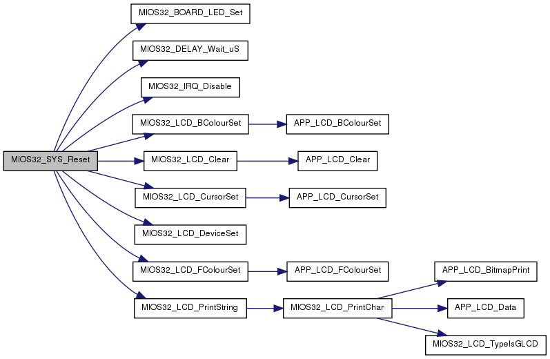

s32 MIOS32_SYS_Reset ( void   )
Shutdown MIOS32 and reset the microcontroller:
  • disable all RTOS tasks
  • print "Bootloader Mode " message if LCD enabled (since MIOS32 will enter this mode after reset)
  • wait until all MIDI OUT buffers are empty (TODO)
  • disable all interrupts
  • turn off all board LEDs
  • send all-0 to DOUT chain (TODO)
  • send all-0 to MF control chain (if enabled) (TODO)
  • reset STM32
Returns:
< 0 if reset failed
