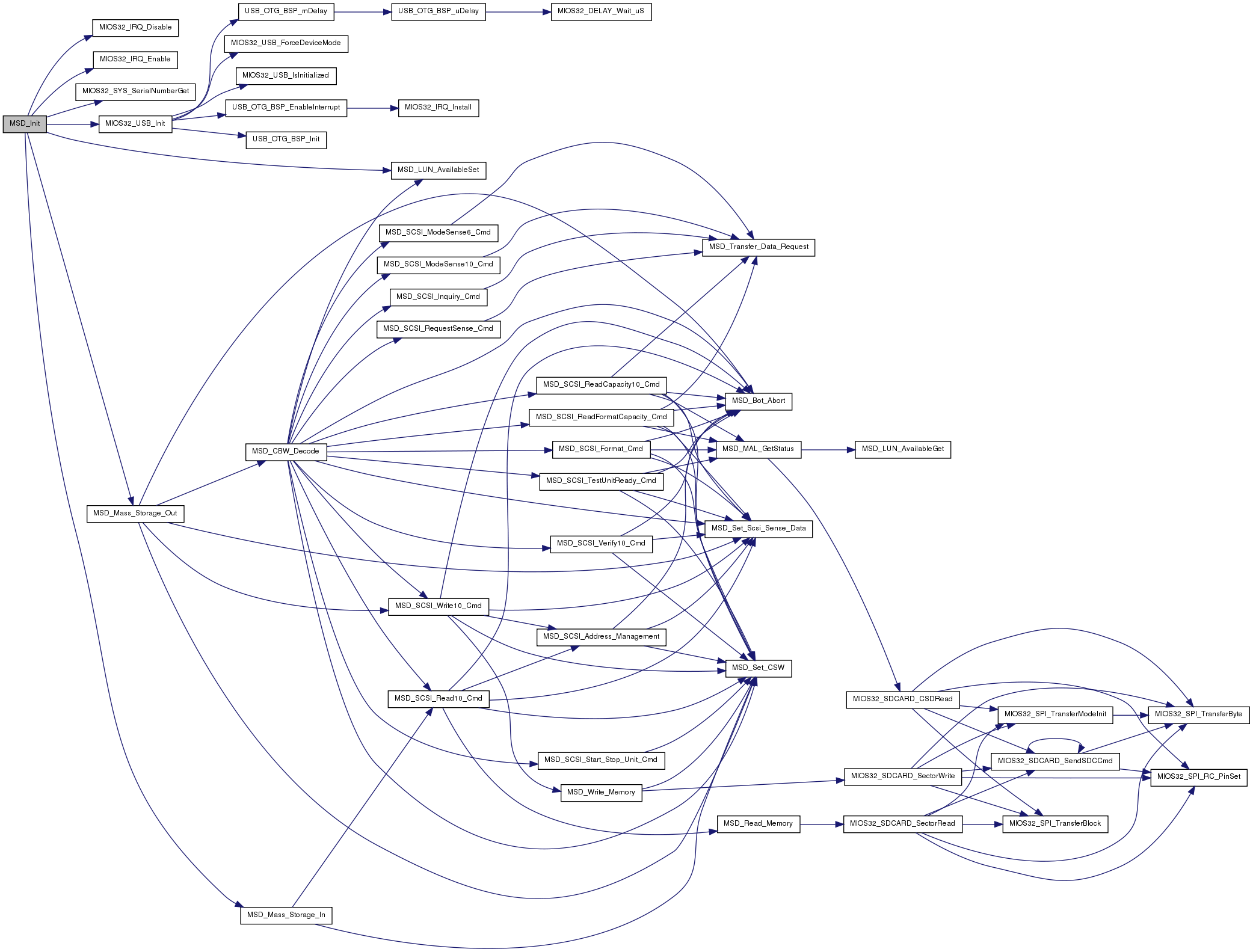

s32 MSD_Init ( u32  mode  )
Initializes the USB Device Driver for a Mass Storage Device
Should be called during runtime once a SD Card has been connected.
It is possible to switch back to the original device driver provided by MIOS32 (e.g. MIOS32_USB_MIDI) by calling MIOS32_USB_Init(1)
Parameters:
[in] mode currently only mode 0 supported
Returns:
< 0 if initialisation failed
