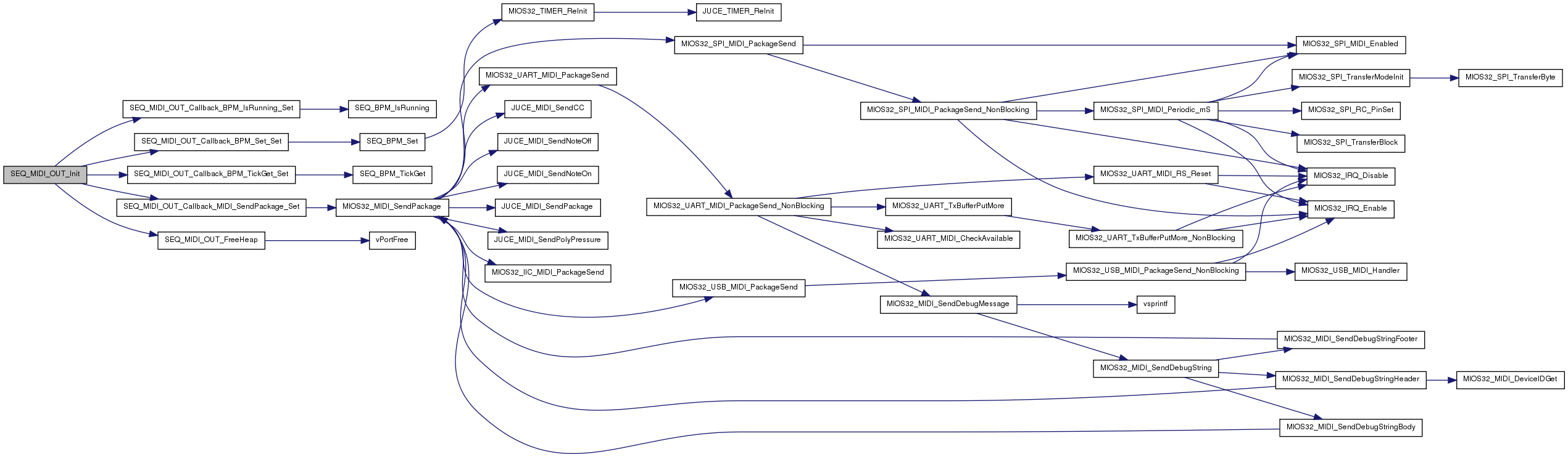

SEQ_MIDI_OUT
Data Structures
struct  seq_midi_out_queue_item_t
Defines
#define DEBUG_VERBOSE_LEVEL   1
#define SEQ_MIDI_OUT_MALLOC_FLAG_WIDTH   1
#define SEQ_MIDI_OUT_MALLOC_FLAG_MASK   1
Functions
s32 SEQ_MIDI_OUT_Init (u32 mode)
s32 SEQ_MIDI_OUT_Callback_MIDI_SendPackage_Set (void *_callback_midi_send_package)
s32 SEQ_MIDI_OUT_Callback_BPM_IsRunning_Set (void *_callback_bpm_is_running)
s32 SEQ_MIDI_OUT_Callback_BPM_TickGet_Set (void *_callback_bpm_tick_get)
s32 SEQ_MIDI_OUT_Callback_BPM_Set_Set (void *_callback_bpm_set)
s32 SEQ_MIDI_OUT_Send (mios32_midi_port_t port, mios32_midi_package_t midi_package, seq_midi_out_event_type_t event_type, u32 timestamp, u32 len)
s32 SEQ_MIDI_OUT_ReSchedule (u8 tag, seq_midi_out_event_type_t event_type, u32 timestamp, u32 *reschedule_filter)
s32 SEQ_MIDI_OUT_FlushQueue (void)
s32 SEQ_MIDI_OUT_FreeHeap (void)
s32 SEQ_MIDI_OUT_Handler (void)
Variables
u32 seq_midi_out_allocated
 contains number of events which have allocated memory

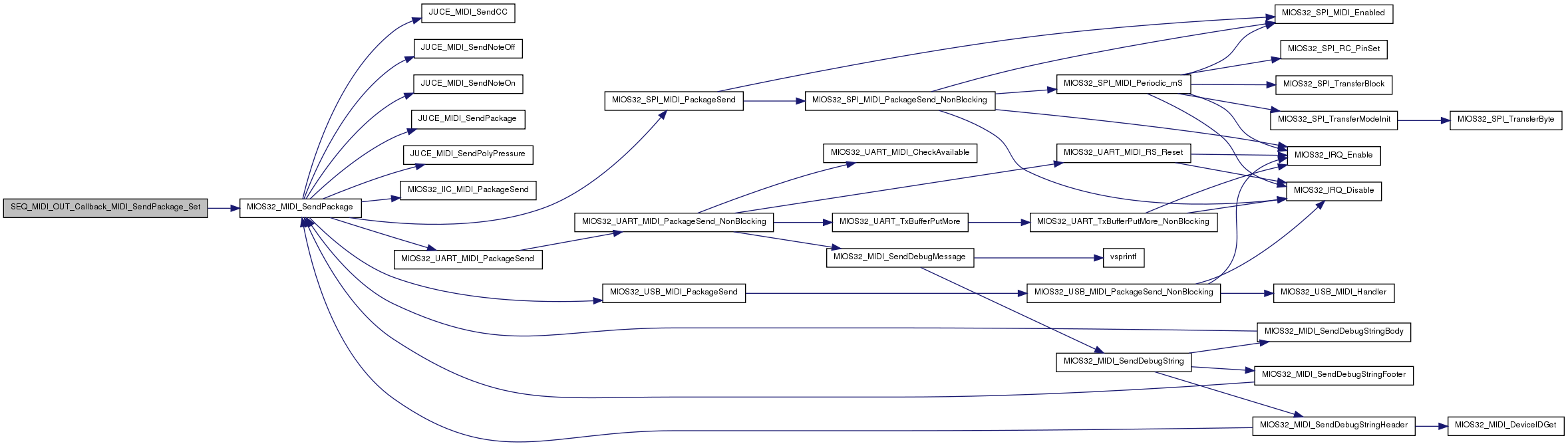

s32 SEQ_MIDI_OUT_Callback_MIDI_SendPackage_Set ( void *  _callback_midi_send_package  )
Allows to change the function which is called whenever a MIDI package should be sent.
This becomes useful if the MIDI output should be filtered, converted or rendered into a MIDI file.
Parameters:
[in] *_callback_midi_send_package pointer to callback function:
   s32 callback_midi_send_package(mios32_midi_port_t port, mios32_midi_package_t midi_package)
     // do something with port and midi_package
     return 0; // no error
If set to NULL, the default function MIOS32_MIDI_SendPackage function will be used. This allows you to restore the default setup properly.
Returns:
< 0 on errors
