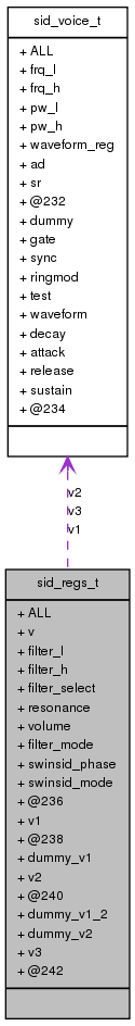

Collaboration diagram for sid_regs_t:
Collaboration graph
[legend]
Data Fields
u8 ALL [SID_REGS_NUM]
struct {
   u8   v [3][7]
   u8   filter_l
   u8   filter_h
   u8   filter_select:4
   u8   resonance: 4
   u8   volume: 4
   u8   filter_mode: 4
   u8   swinsid_phase [3]
   u8   swinsid_mode [3]
struct {
   sid_voice_t   v1
struct {
   u8   dummy_v1 [7]
   sid_voice_t   v2
struct {
   u8   dummy_v1_2 [7]
   u8   dummy_v2 [7]
   sid_voice_t   v3
