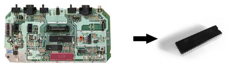

On the motherboard:
Where?
Have a look at 2600 Connection site to find it.
TIA = “Stella” = MM9031N = UM6525N = CO10444 = CO10444D (NTSC, U.S.A. & SECAM, France)
TIA = “Stella” = UM6526P1 = CO11903 (PAL, Europe + Australia + most of the rest of the world)

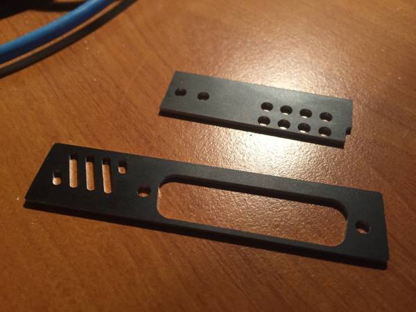

I decided to case it in a cartridge, because it makes this project a tiny one, easy to build and cheap. In short, an accessible start-up project, which need reasonable time to realize, share and present correctly.

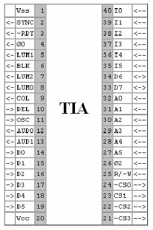

TIA Pin Out
As seen in “How>Registers Address”, we don't need to use all adress and data pins.
Pins A5, D5, D6, D7, CS0#, CS2#, CS3# must be grounded.
Pins A4, CS1 must be connected to 5V.
We use only Address lines A0-A3, Data lines D0-D4 and WR# line.
Divided by 3 Clock output 00 must be connected to input 02.

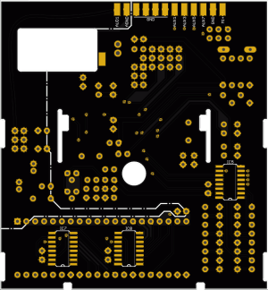

PCB files

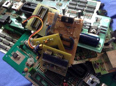

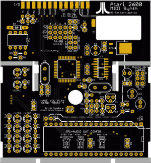

I made a lot of breadboards and stripboards before first cartridge prototype.
It's really easy but i prepared an Eagle Project for people who want design . Maybe it will be usefull to replace the clock section by an Oscillator.
*.sch is ready, *.brd is consistent but in airwires state… If somebody have done(or wanna do) this work, i will be happy to publish it and complete this section.

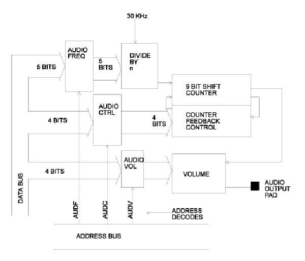

Synthesis:
There are two audio circuits for generating sound. They are identical but completely independent and can be operated simultaneously to produce sound effects through the TV speaker. Each audio circuit has three registers that control a noise-tone generator (what kind of sound), a frequency selection (high or low pitch of the sound), and a volume control.
Each audio circuit consists of parts described below:
Synthesis Schematic

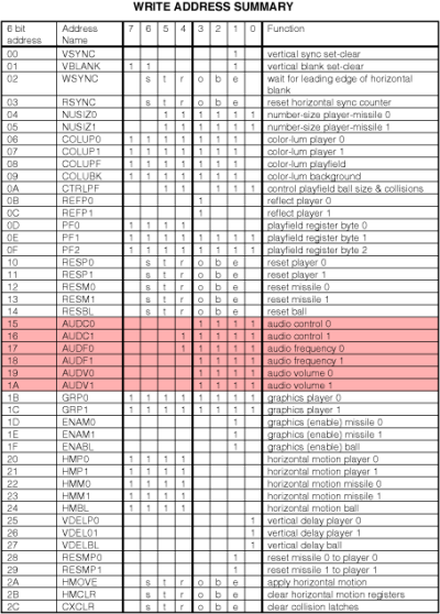

Registers Address
Registers Address
Those two audio generators use 6 registers:
  • AUDCx (4bit), Waveform control(x2)
  • AUDFx (5bit), Pitch control(x2)
  • AUDVx (4bit), Volume control(x2)
AUDx registers adresses start @ 0x15 (21)
0x15= 010101
0x16= 010110
0x17= 010111
0x18= 011000
0x19= 011001
0x1a= 011010
So we need 4 bit of address only. And 5 bit max for data (AUDFx).
Data bit 7,6,5 and Adress bit 5 are cleared. Adress bit 4 is set.

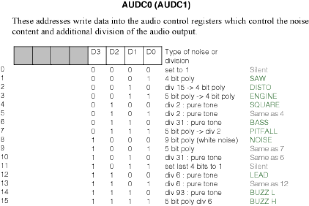

Waveform & Noise Control:
The noise-tone generator is controlled by writing to the 4 bit audio control registers (AUDC0, AUDC1). The values written cause different kinds of sounds to be generated. Some are pure tones like a flute, others have various “noise” content like a rocket motor or explosion.
This circuit contains a nine bit shift counter which may be controlled by the output code from a four bit audio control register(AUDC), and is clocked by the frequency select circuit. The control register can be loaded by the microprocessor at any time, and selects different shift counter feedback taps and count lengths to produce a variety of noise and tone qualities.
Even though the TIA hardware manual lists the sounds created by each value, some experimentation will be necessary to find “your sound”.
AudCx registers value
These are 16 in number (4 bits). But some are the same or are silent. So only 10 waveforms are available.

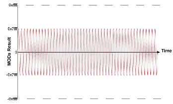

Amplitude:Volumes
Master Volume(CC#7) allow to increase or decrease general volume and keep the relative mixing between the two Voices (CC#9-10).
With V12 Volume (CC#8), single Volumes(CC#9-10) will be linked and equals.
  • 0 ≤ Vx_VOLUME ≤ 0x7f(7bit)
  • 0 ≤ MASTER_VOLUME ≤ 0x7f(7bit)
AMP = Vx_VOLUME * MASTER_VOLUME / 127

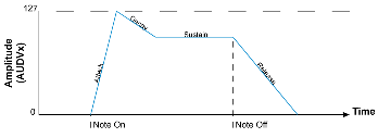

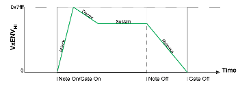

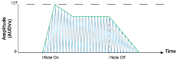

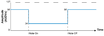

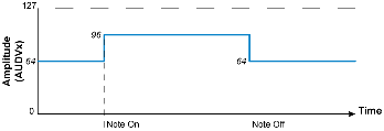

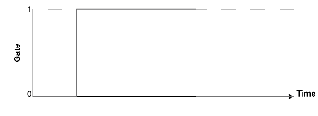

Amplitude:Vx Gate

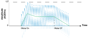

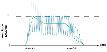

I recreated the Gate and its GSA (CC#19-21) feature by software.
AMP(AUDVx) with GSA On and positive Velocity Depth
Gate Stay active option maintain the Gate High and allow to dig in Amplitude(useful when depth velocity or envelope are negatives).
GSA in Voice Mode Controller:
CC # | Hex | Description                                  | Range       | Reset
  19 | 13h | Voice 1/2 Mode                               |             |    0
     |     |   Bit 0: Gate Stay Active on/off             |             |
  20 | 14h | Voice 1 Mode                                 | see above   |    0
  21 | 15h | Voice 2 Mode                                 | see above   |    0
I add a fade out section to avoid 'clicks' on abrupt amplitude fall down.
Adjust it in setup_tia_*.asm
    ;; Adjustable Gate fade out option:
    ;; to avoid click when envelope is off or envelope release is null.
    ;; Uses USER_Timer period N * 819 (us), default N=2 (1.638ms).
#define DEFAULT_TIA_GATE_FADEOUT   2

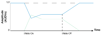

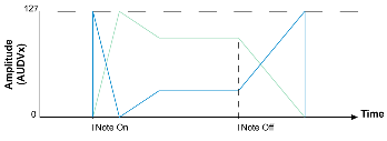

Amplitude:Vx Velocity
Velocity response for both voices Amplitude(CC#19-21). With optional CC# Assign(CC#43-45).
It will play Init value(CC#4-6) if Velocity input is less than it.
  • 0 ≤ Vx_LAST_VEL ≤ 0x7f(7bit)
  • 0 ≤ Vx_INIT_VEL ≤ 0x7f(7bit)
If Vx_LAST_VEL ≤ Vx_INIT_VEL then Vx_LAST_VEL = Vx_INIT_VEL
A negative depth value(CC#13-25) will reverse the effect, harder you play, lower it sounds.
  • GSA Off
  • - 0x3f(6bit) ≤ Vx_DEPTH_VEL ≤ + 0x3f(6bit)
If Vx_DEPTH_VEL > 0 then
AMP = AMP * [ ( Vx_LAST_VEL / 127 ) * ( Vx_DEPTH_VEL / 63 ) ]
If Vx_DEPTH_VEL < 0 then
AMP = AMP * [ 1 - [ ( Vx_LAST_VEL / 127 ) * ( |Vx_DEPTH_VEL| / 63 ) ] ]
Velocity to Amplitude Enabler in Vx Mode Controller:
     |     |   Bit 3: Velocity to Amplitude on/off        |             |

e.g. Positive Velocity Depth.
  • GSA On
  • AMP = 64
  • Vx_DEPTH_VEL = + 32
  • Vx_LAST_VEL= 127
AMP = 64 + ( 127 - 64) * [ ( 127 / 127 ) * ( 32 / 63 ) ] ≈ 96
e.g. Negative Velocity Depth.
  • GSA On
  • AMP = 96
  • Vx_DEPTH_VEL = - 63
  • Vx_LAST_VEL= 82
AMP = 96 - 96 * [ ( 82 / 127 ) * ( 63 / 63 ) ] ≈ 34
Amplitude:Vx Envelope
TIA needs Envelopes to be a real synth and have its behaviour…
I chose to decrease LFOs number by 2 and add one dedicated envelope per voice.
Ok now, we've got 4LFOs and 4 ENVs…
For each 2 dedicated Envelopes (VxENV) :
If enabled(CC#19-21) and Depth(CC#49-51) is not null then the Gate reset will be delayed by the envelope release.
  • 0 ≤ VxENV ≤ 0x3f00(15bit)
= AMP * VxENVHI / 127
AMP(AUDVx) positive Envelope Depth

Envelope Depth :
A negative Depth(CC#49-51) value will reverse the effect.
e.g. Positive Depth. AMP
  • GSA Off
  • Vx_DEPTH_VEL = + 63
e.g. Negative Depth.
  • GSA Off
Negative depth inverts the VxENV waveform.
And AMP will follow.
AMP(AUDVx) negative Envelope Depth
e.g. Negative Depth with GSA Enabled. AMP
  • GSA On
  • Vx_DEPTH_VEL = - 36
AMP(AUDVx) negative Envelope Depth, GSA on

What will happen if I assign another mod via the voice modulation matrix?
From the Modulation Matrix:
  • - 0x7f00(15bit) ≤ LFOx ≤ + 0x7f00(15bit)
  • - 0x7f00(15bit) ≤ ENVVx ≤ + 0x7f00(15bit)
  • - 0xff00(16bit) ≤ MODs ≤ + 0xff00(16bit)
MODs = LFO1_VALUE + … + LFO4_VALUE + ENV1_VALUE + ENV2_VALUE
MODs e.g. LFO1 enabled
e.g. Modulation Matrix LFO1 to Vx Amplitude is enabled.
  • Vx_DEPTH_VEL = + 31 (mid pos)
AMP = AMP * ( VxENVHI + MODsHI )
AMPs e.g. A+B Mode
Like the extra modulations mixer, it results in the addition of the dedicated envelope value and the Matrix Modulation result.
And it's not really what I wanted. As you can see, the MODS result alters the envelope. At the end of the release, amplitude is not zero, which causes audio clicks.
My issue was to add two others Mixing modes…

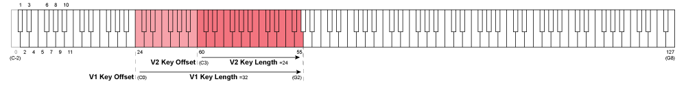

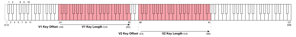

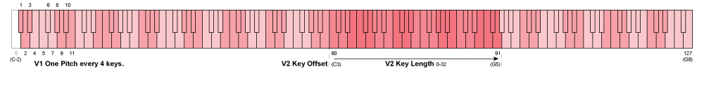

Pitch:Key Extended Option
This feature is a bit enabler located in the Voice Mode Controller(CC#19-21).
In normal mode, it splits a keyboard in 2 ranges of Keys Length(CC#40-42), which start at their respective Note Offsets(CC#37-39), there's one range per Voice.
In Extended mode, the 32 notes scale of the TIA is expanded to the keyboard midi range (128 notes). So 4 Keys per value.
Voices can share same MIDI Channel.
Key extended Enabler in Vx Mode Controller:
     |     |   Bit 2: Keyboard Extended on/off            |             |
Key extended is off (normal mode).
  • 1 ≤ Vx_KEY_OFFSET ≤ 127 (0=off)
  • 0 ≤ Vx_KEY_LENGTH ≤ 31
  • 1 ≤ Vx_NOTE ≤ 127
If Vx_NOTE ≥ Vx_KEY_OFFSET AND Vx_NOTE ≤ ( Vx_KEY_OFFSET + Vx_KEY_LENGTH ) then
FREQHI = ( Vx_NOTE - Vx_KEY_OFFSET ) « 3
FREQLO = 0
  37 | 25h | Voice 1/2 Key Offset                         | 0-127: val  |   24
  38 | 26h | Voice 1 Single Key Offset                    |             |   24
  39 | 27h | Voice 2 Single Key Offset                    |             |   60
     |     | Note: Inactive if Key Extended On            |             |
  40 | 28h | Voice 1/2 Key Length                         | 0-31: val   |   31
  41 | 29h | Voice 1 Single Key Offset                    |             |   31
  42 | 2Ah | Voice 2 Single Key Offset                    |             |   31
  • e.g. Default configuration.
  • V1_Offset=24, Length=32.
  • V2_Offset=60, Length=32.
  • e.g. Voices can share same zone region or entire zone.
  • V2_Offset=36, Length=20.
Key extended is on.
  • 1 ≤ Vx_NOTE ≤ 127
FREQHI = Vx_NOTE « 1
FREQLO = 0
  • e.g. V1 & V2 in KeyExtended mode.
  • e.g. Only V1 in KeyExtended mode.

The aluminum backplane
dxf and fpd files
It's a 1.5mm thick aluminum plate.
There's two part which have to be separated
Right part is the backplane for the synth connector(a DB25 F).
Left is to help you drilling the led holes, just place it inside the top cover and use a 3mm drill bit:
PCB
This is version 2, there's some improvements since version 1.
Schematic
Layout
Top layer…
Bottom layer, Seeed render.
Note: Because of the PIC package… If you haven't got any PIC Burner, I can solder the IC and burn the bootloader for you, just tell me.
