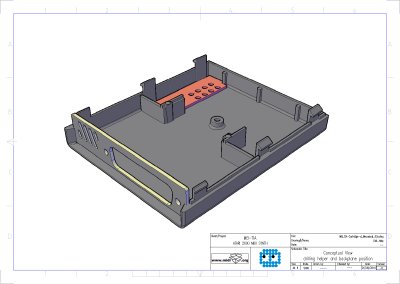

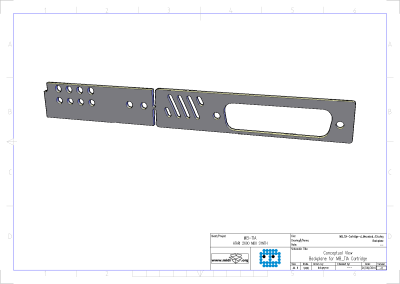

I decided to case it in a cartridge, because it makes this project a tiny one, easy to build and cheap. In short, an accessible start-up project, which need reasonable time to realize, share and present correctly.

The MIDIbox TIA Cartridge Version
Building it!
You will need:
  • A TIA chip.
  • A game Cartrige with sticker and internal EPROM removed.
  • The last version of the PCB.
  • The last version of the aluminum backplane.
  • Some components, wire and connectors.

Note: How to drill the led holes is explained in the next 'backplane' chapter.
The aluminum backplane
dxf and fpd files
It's a 1.5mm thick aluminum plate.
There's two part which have to be separated
Right part is the backplane for the synth connector(a DB25 F).
Left is to help you drilling the led holes, just place it inside the top cover and use a 3mm drill bit:
