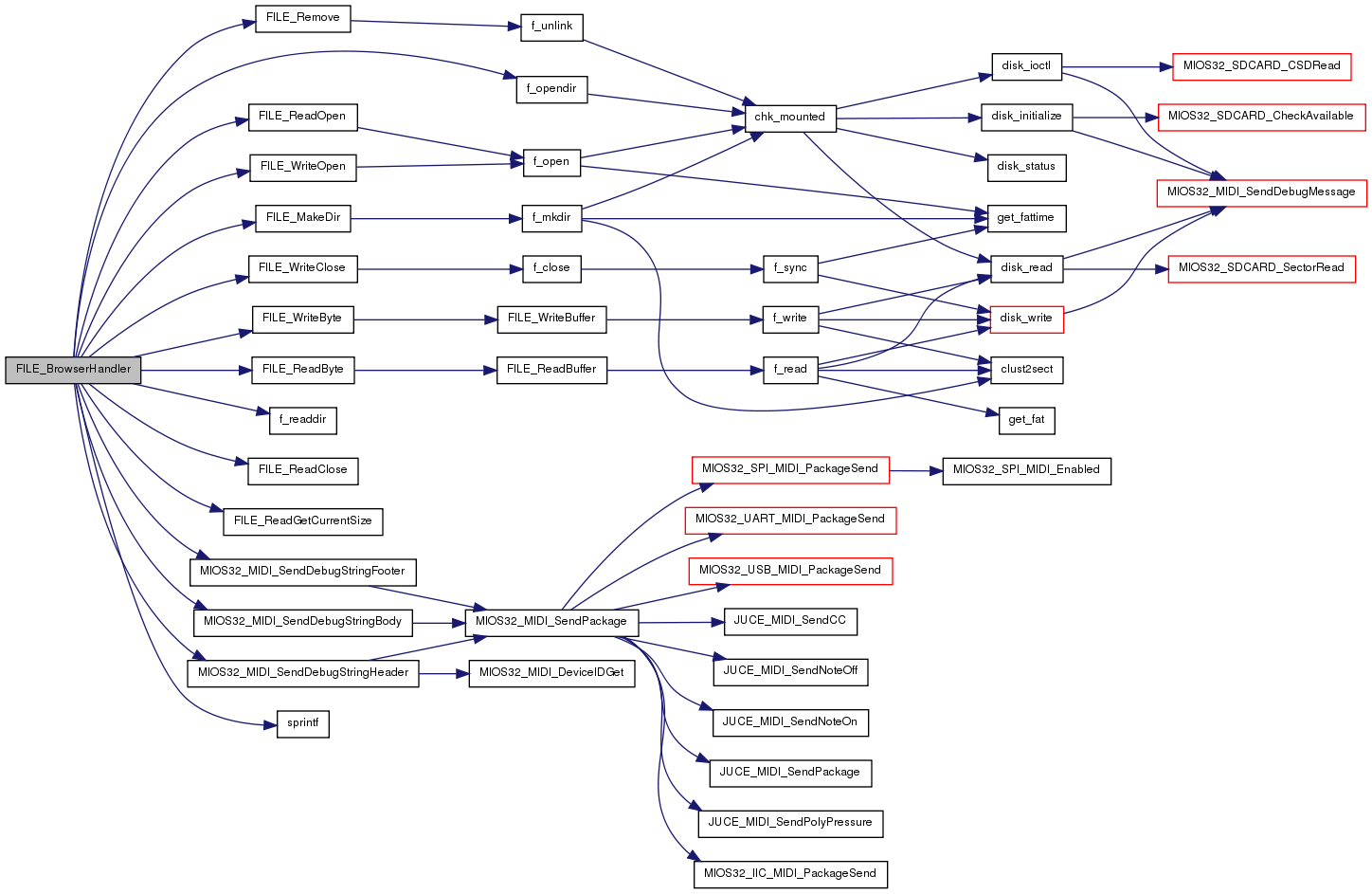

s32 FILE_BrowserHandler ( mios32_midi_port_t  port,
char *  command
Handler for MIOS Studio Filebrowser accesses.
See $MIOS32_PATH/apps/controllers/midio128/src/terminal.c for usage example.

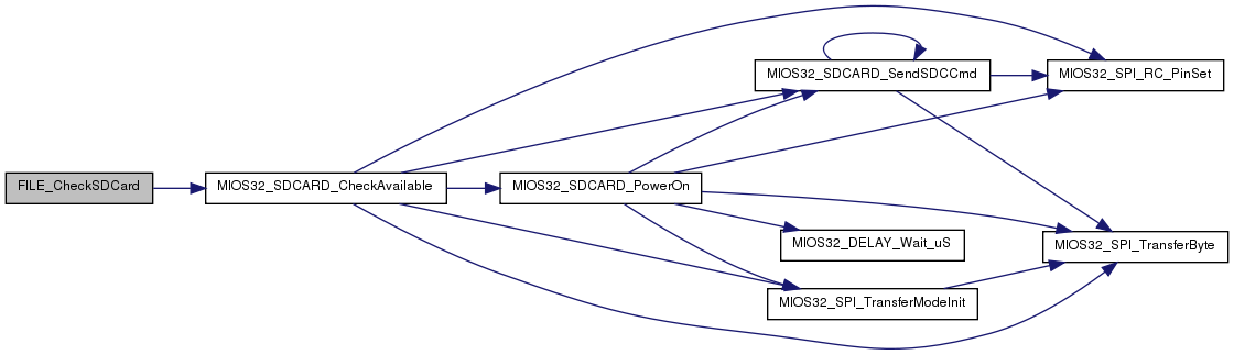

s32 FILE_CheckSDCard ( void   )
This function should be called periodically to check the availability of the SD Card
Returns:
< 0 on errors (error codes are documented in file.h)
1 if SD card has been connected
2 if SD card has been disconnected
3 if new files should be loaded, e.g. after startup or SD Card change

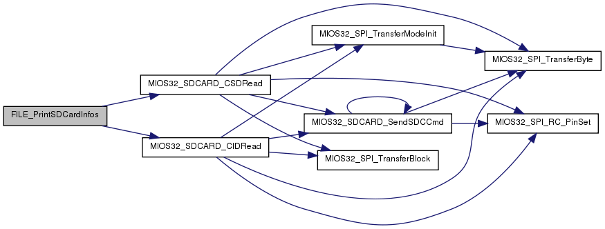

s32 FILE_PrintSDCardInfos ( void   )
This function prints some useful SD card informations on the MIOS terminal
