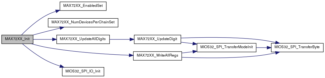

s32 MAX72XX_Init ( u32  mode  )
Initializes MAX72xx driver Should be called from Init() during startup
Parameters:
[in] mode currently only mode 0 supported
Returns:
< 0 if initialisation failed
