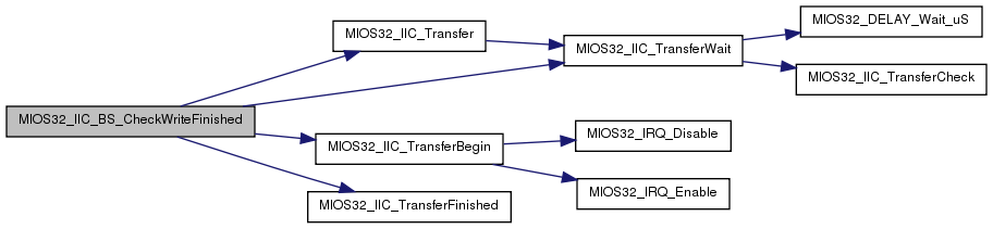

s32 MIOS32_IIC_BS_CheckWriteFinished ( u8  bs  )
Has to be used after MIOS32_IIC_BS_Write (during write operation) to poll the device state
Parameters:
[in] bs BankStick number (0-7)
Returns:
1 if BankStick was available before, and now doesn't respond: write operation is in progress
0 if BankStick available, write operation finished
-1 if error during IIC transfer
-2 if BankStick blocked by another task (retry it!)
-3 if BankStick wasn't available at last scan

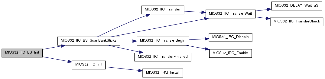

s32 MIOS32_IIC_BS_Init ( u32  mode  )
Initializes BankSticks
Parameters:
[in] mode currently only mode 0 supported
Returns:
< 0 if initialisation failed

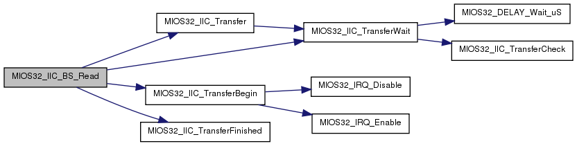

s32 MIOS32_IIC_BS_Read ( u8  bs,
u16  address,
u8 *  buffer,
u8  len
Reads one or more bytes into a buffer
Parameters:
[in] address BankStick address (depends on size)
[out] buffer destination buffer
[in] len number of bytes which should be read (1..64)
Returns:
0 if operation was successful
-4 if invalid length

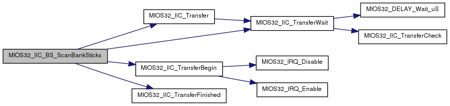

s32 MIOS32_IIC_BS_ScanBankSticks ( void   )
Scans all BankSticks to check the availablility by sending dummy requests and checking the ACK response.
Per module, this procedure takes at least ca. 25 uS, if no module is connected ca. 75 uS (3 retries), or even more if we have to wait for completion of the previous IIC transfer. Therefore this function should only be rarely used (e.g. once per second), and the state should be saved somewhere in the application
Returns:
0 if all BankSticks scanned
-2 if BankStick blocked by another task (retry the scan!)
