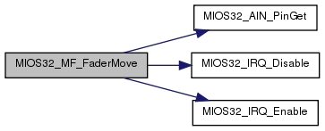

s32 MIOS32_MF_FaderMove ( u32  mf,
u16  pos
set target position and move fader
Parameters:
[in] mf motor number (0..MIOS32_MF_NUM-1)
[in] pos motorfader position (resolution depends on the used AIN resolution, usually 12bit)
Returns:
-1 if motor doesn't exist
