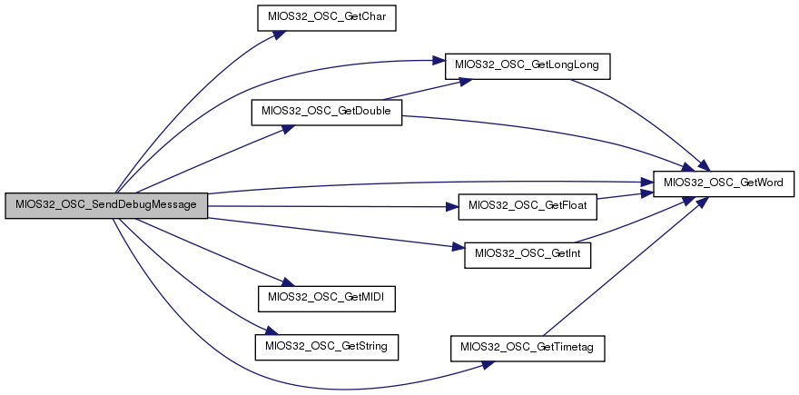

s32 MIOS32_OSC_SendDebugMessage ( mios32_osc_args_t *  osc_args,
u32  method_arg
Sends the argument list of a method to the debug terminal.
By default, the message is sent via MIDI to the MIOS Studio terminal.
Optionally another output function can be used (e.g. printf in emulation) by overruling MIOS32_OSC_DEBUG_MSG in mios32_config.h
