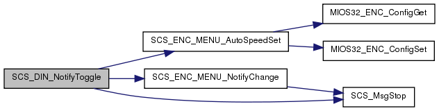

s32 SCS_DIN_NotifyToggle ( u8  pin,
u8  depressed
This function should be called from APP_DIN_NotifyToggle when a button has been toggled
Parameters:
[in] pin the pin number (SCS_PIN_xxx)
[in] depressed the pin state
Returns:
< 0 on errors

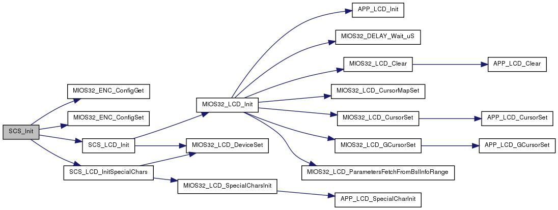

s32 SCS_Init ( u32  mode  )
Initialisation of Standard Control Surface
Parameters:
[in] mode currently only mode 0 supported
Returns:
< 0 if initialisation failed

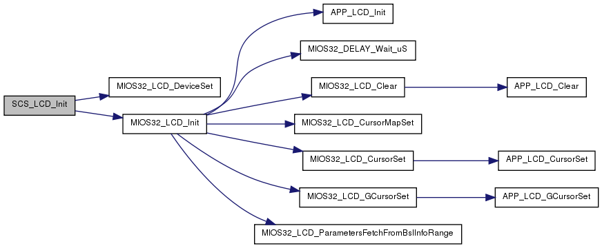

s32 SCS_LCD_Init ( u32  mode  )
Display Initialisation

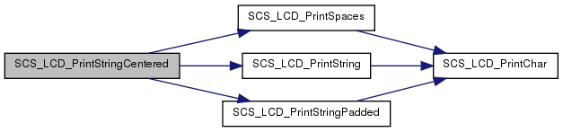

s32 SCS_LCD_PrintStringCentered ( char *  str,
u32  width

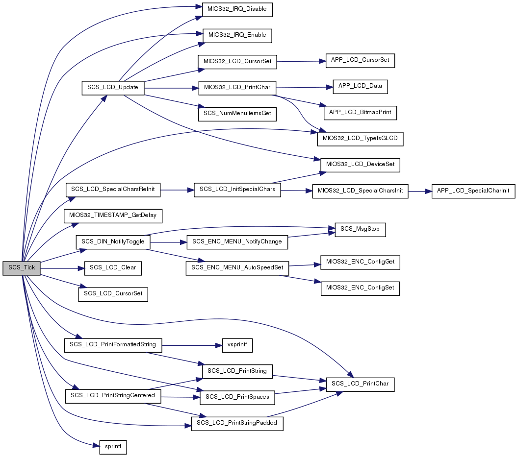

s32 SCS_Tick ( void   )
This handler should be called from a FreeRTOS task each millisecond with low priority
Returns:
< 0 on errors
