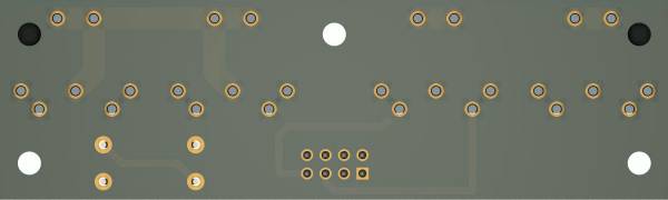

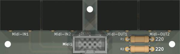

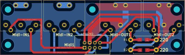

core4discmidiex
Core4Disc Midi-Expansion
this is one essential part for my triggermatrix5
Shematic
Building and BOM
Handsolder, easy project…
BOM
^Qty ^Reference(s) ^Value ^Footprint ^Mouser^
1 Midi1 Pin-Head-2×4 PinHead-Shrd-2×4-THT 649-75869-232LF
4 Midi-IN1-2, Midi-OUT1-2 Din 5Pole KCDX5SS2 806-KCDX-5S-S2
2 R1, R2 220 THT or 1206 SMD: 660-RK73B2BTTD221J THT: 281-220-RC
R1 and R2 can be solderd as Thruhole, or SMD1206 Package
