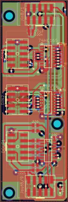

it gives;
16 Digital Inputs
8 Digital Outputs
The Board is fully SMD, and made for pick and place - so no soldering required!
Shematic
Building and BOM
Its build by pick and place robots… so no need to build, or order any component
you need this PCB 1x for OpenPAD
BOM
Follwing list is for reference, and debugging only, no need to order them! all the parts are already soldered on the PCB!
