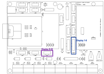

You will need to set the Connection of the Display.
So all 3 Code Resistors need to be on the Left side…
If you don't like the LED on top you can de-solder it now.
The first PCB gets its Selection Lines from the Display Connection J15A on the Core PCB. So you will need to solder the 16Pin Header at this Panel. Here you can leave out the 10pin Headers and the IC Socket for the Shift register, if you like.
The Second PCB for Display 9-16 gets its Selection lines from the Shift register and doesn't need the 16pin Header so you have to solder J1 and J2 but you can leave out J0.
For both use cases you need to stuff the Resistor array so its best to solder a 16pin IC-Socket and stuff it in that.
PCB 3&4 are same as the second.
