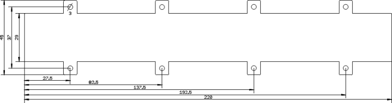

Standard 220mm wide Modules

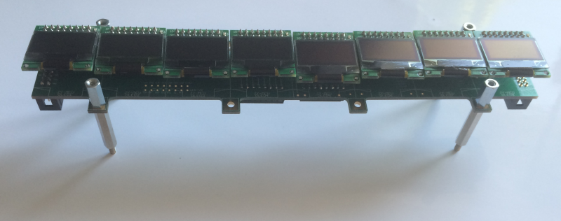

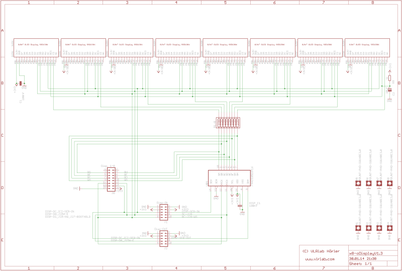

VLR-8oDisp
A PCB for chaning up to 32 OLEDs on 4×8 OLED Modules.
It can be connected to the RTPMIDI-CORE-STM32F4 from BEB DigitalAudio.

- 2x10pin Header, 517-30310-6002
- 1x16pin Header, 517-30316-6002
- 2x16Pin DIP, 571-1-390261-4
- 1xResistor Array 220Ohm, 652-4116R-1LF-220
- 1x74HC595, 595-SN74HC595N
- 2x100nF, 505-MKS2.1/63/5
- 1x100uF, 667-ECE-A1EKA100
- 1x1kOhm, 660-MF1/4DCT52A1001F
- 8xFemale Header, 649-66953-008

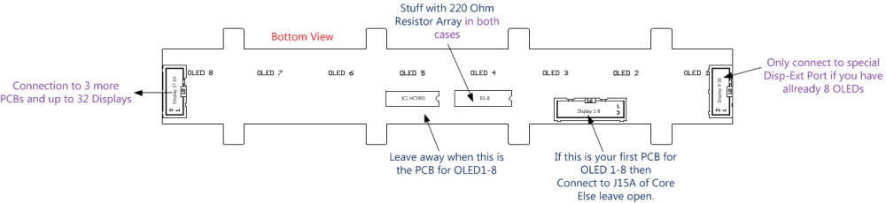

Prepare the PCB

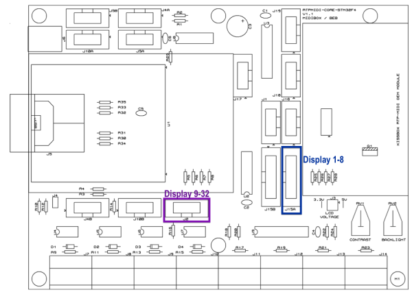

The first PCB gets its Selection Lines from the Display Connection J15A on the Core PCB. So you will need to solder the 16Pin Header at this Panel. Here you can leave out the 10pin Headers and the IC Socket for the Shift register, if you like.
The Second PCB for Display 9-16 gets its Selection lines from the Shift register and doesn't need the 16pin Header so you have to solder J1 and J2 but you can leave out J0.
For both use cases you need to stuff the Resistor array so its best to solder a 16pin IC-Socket and stuff it in that.
PCB 3&4 are same as the second.
