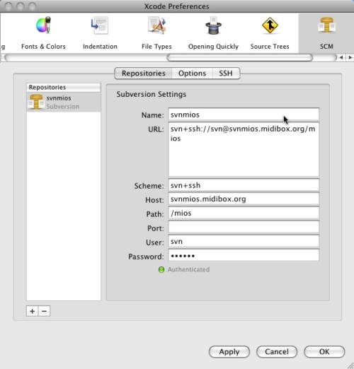

click on the menu items SCM → Configure Repositories

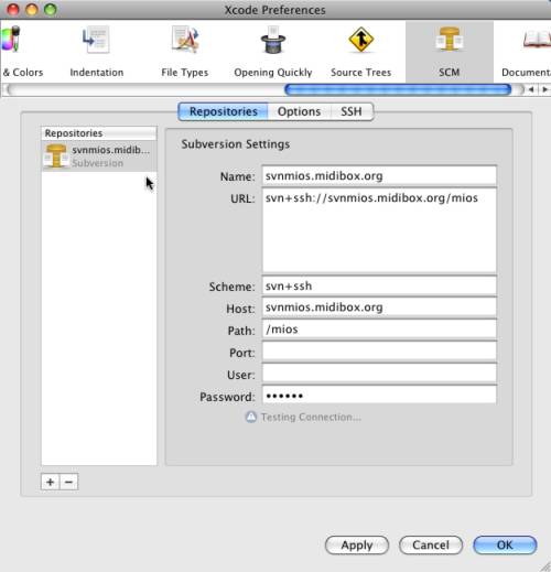

Enter in the information for the midibox svn repository exactly as shown here. But don't click apply just yet.
UPDATE: the URL should now read “svn+ssh:svn@midibox.org/mios”.**

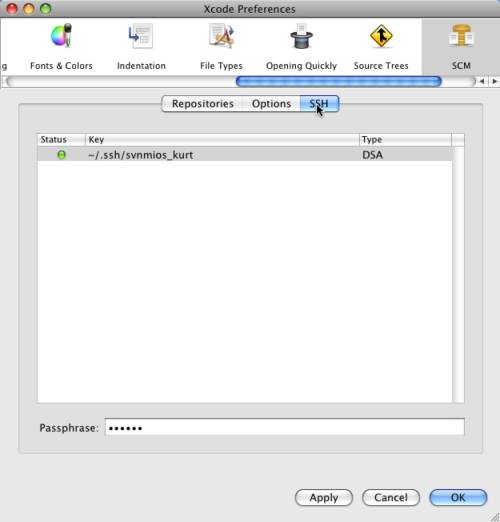

Select the SSH tab and make sure that your svnmioskey file is listed there. If it's not, restart Xcode. Enter your passphrase.
Select the Repository tab and click the apply button. It will show that it's testing the connection.
In a few seconds another dialog will pop up requesting your passphrase (I don't have an image of it yet).
When it's done it will show that it's authenticated.
