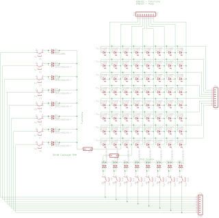

LED Matrix
This is a proposed layout for an LED matrix board to be used coupled with the above panel design. While other boards can likely be made from home using various methods, it might be wise to have this one printed. Note that this design currently has the mounting holes up higher than the current design of the front panel. The mounting holes were moved down on the panel so the design was more uniform. Modify per your needs!
Eagle
A Bulk Order may end up being organized once I finalize the details of the layout. In fact all of the above links are already old :) If you want to know more about the latest happenings, check out this forum post.

Part Description Mouser Farnell
S1-S16 6mm x 6mm Tactile Switch
D1-D16 SMD Switching Diode 1N4148W-V-GS08 13114|1n4148w-v-gs08||S|e|5480397067|1469425
LED1-LED64 3mm LED
JD5, JD6, JD8 SIL Pin Header
Note that other SMD diodes may work, such as Mini-MELF.
