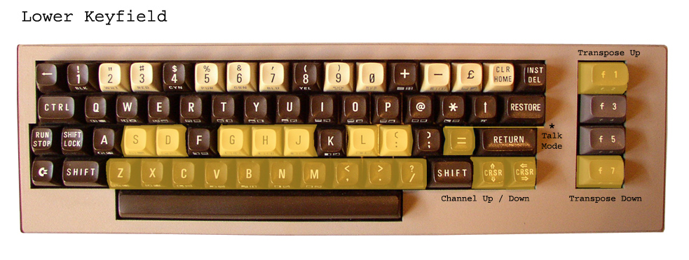

Setup keyfields
On the right side of screen the adjustable channel- and transpose-values for UPPER and LOWER keyfield are shown. CH1 (for LOWER keyfield) can be changed with CRSR keys up down, CH2 (for UPPER keyfield) is variable by + and -. Pushing F1 and F7 will change the transpose value (TR1). For the UPPER Keyfield TR2 is adjustable in 2 ways: Pushing SHIFT_R + F1 and SHIFT_R + F7 or pushing simply the SPACE key. A short touch of the space button transposes TR2 up, a longer touch transposes TR2 down. All Parameters will be stored internal.

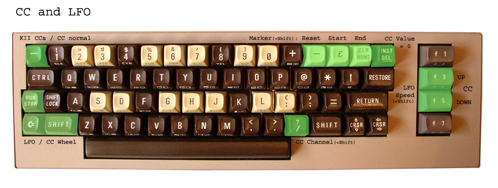

CCs and Values
On the right side of screen the adjustable CC and CC Values are shown. The pointer char “>” infront of Midi-Channel presents the current Channel for a choosen CCs. SHIFT_R + ? switches the CC pointer between the 2 keyfields. CCs are adjustable with F3 and F5. The Keys COMMODORE and SHIFT_L presents the datawheel of K64. CC Values are sended out by moving CC Value up and down with that keys. INST/DEL Key sets values back to 0.
Triangle LFO
There is an integrated LFO option to automate some functions of the datawheel. The LFO option changes the CC Values in a specific interval up and down. Close to CC Value area, there are 2 marker adjustable. The Startpointer “>” on the left and Endpointer “<” on the right side. The Start marker is adjustable by pushing SHIFT_R + LIRE key - the end marker by SHIFT_R + CLR/HOME. Changes adjust the border for triangle LFO. SHIFT_R + “-” Key resets default marker position (0..127).
To Start the LFO press RUN/STOP. To Stop the LFO press RUN/STOP again. You can influence the flow by controlling CC Values manually, changing end- and start-position and setup Speed Value.
Start Marker:
End Marker:
Speed option
The speed value (default = 1) behind the value number presents the speed of changing CC Values, which are controlled by datawheel or by LFO. Manual changes are constantly double fast as LFO. Pushing SHIFT_R + F3 or SHIFT_R + F5 will change the speed value. Notice, if the speed value is 0 the LFO will be frozen.

Z..? note Ch1 S..[ halfnote Ch1
Q..UPARROW note Ch2 2..0 halfnote Ch2
RETURN activates/deactivates Upper keyfield Hold-Notes mode (+) SHIFT_R + RET. activates/deactivates SEQV3 Record mode SHIFT_R + SPC. activates/deactivates Union mode (for non-splitted keyfield) SHIFT_R + = activates/deactivates Talk mode for lower keyfield (*)
SPACE short time - transpose up for Ch2 long time - transpose down for Ch2
COMMODORE CC Value down SHIFT_L CC Value up
RUN/STOP Start LFO / Stop LFO
CLR/HOME Reset CC Value (CC Value = 0)
SHIFT_R + INST/DEL Set LFO END mark SHIFT_R + LIRE Set LFO START mark SHIFT_R + - Reset LFO marks
CRSR_LR Ch1 up CRSR_UD Ch1 down SHIFT_R + CRSR_LR Ch2 up SHIFT_R + CRSR_UD Ch2 down
F1 Transpose1 up F7 Transpose1 down SHIFT_R + F1 Transpose2 up SHIFT_R + F7 Transpose2 down
F3 CC up (KII CC up) F5 CC down (KII CC down)
SHIFT_R + F3 Increment LFO Speed SHIFT_R + F5 Decrement LFO Speed (If Speed 0 - LFO will hold)
SHIFT_R + ? Select CC outgoing Channel
