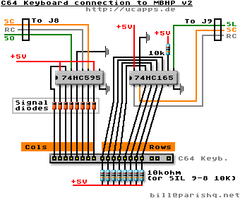

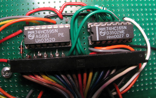

First, i did this pcb (on a breadboard) :
Use that sample program to test your keyboard connection :

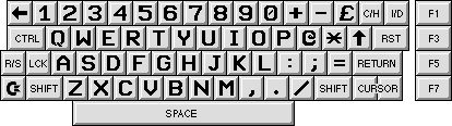

This small app display the key number, the corresponding Character, the midi note number associated to that key, and play a note on channel 1. The keyboard mapping can be found in the “variables.h” file. More than a test, it's a good base for your own programs.
