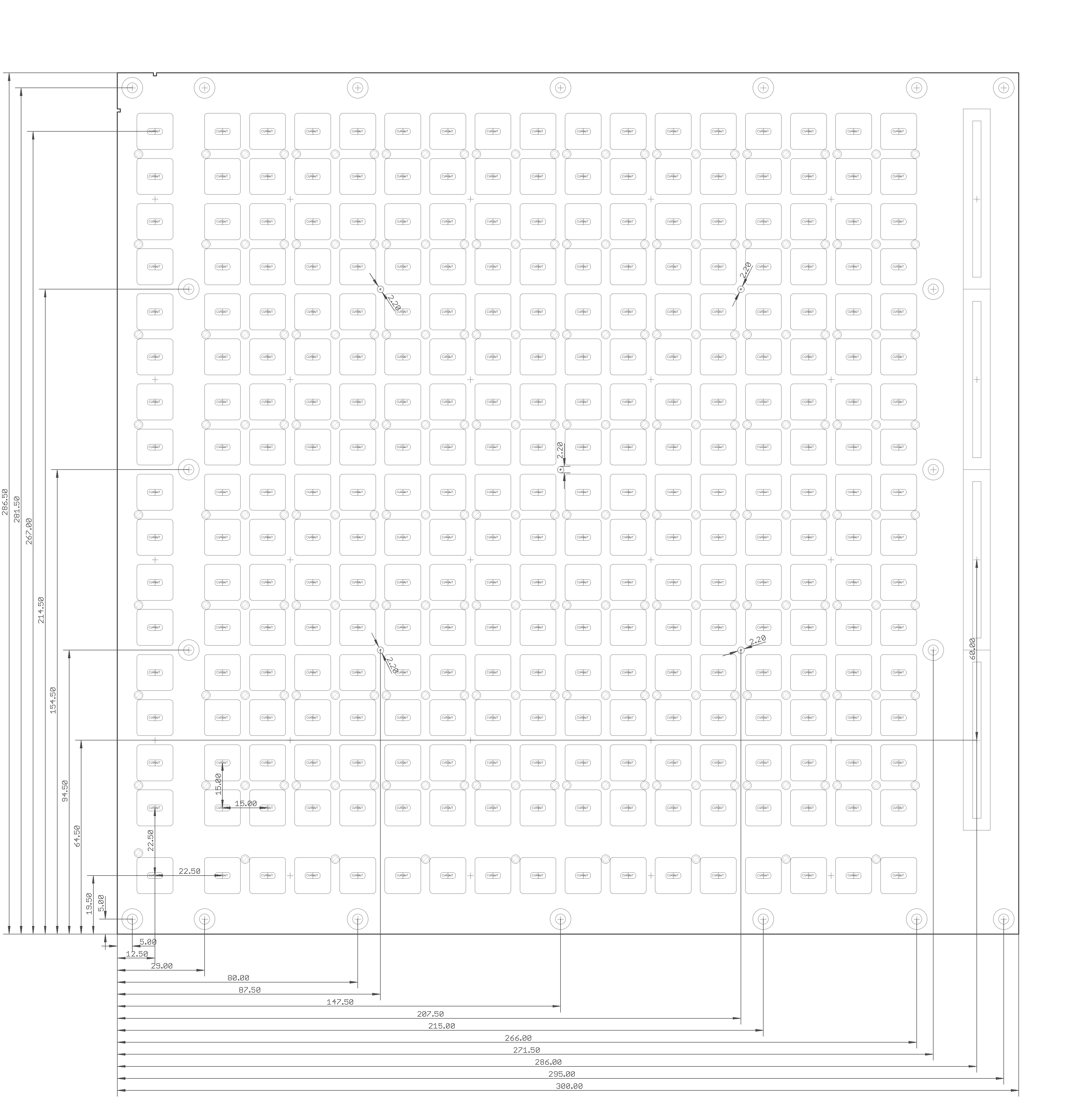

Dimensions
Here are the dimensions for the button, hole and slider locations. Note that the unmarked mounting holes are M3 (3.2mm diameter)
