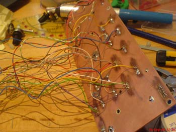

Mounting the parts and attaching cables.
A DIN X4 is piggybacked to each board with M3 srews and spacers.

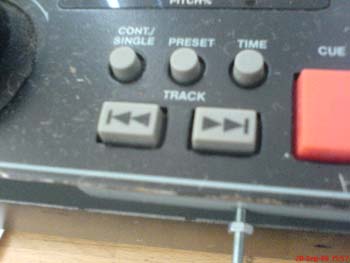

Scuffing the silkscreening away

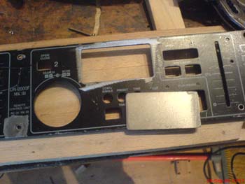

Welding and soldering additional sheet metal to cover the display cutouts.
Partly finished after bondoing and sanding.
