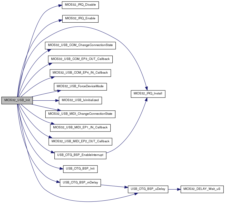

s32 MIOS32_USB_Init ( u32  mode  )
Initializes USB interface
Parameters:
[in] mode
  • if 0, USB peripheral won't be initialized if this has already been done before
  • if 1, USB peripheral re-initialisation will be forced
  • if 2, USB peripheral re-initialisation will be forced, STM32 driver hooks won't be overwritten.
    This mode can be used for a local USB driver which installs it's own hooks during runtime.
    The application can switch back to MIOS32 drivers (e.g. MIOS32_USB_MIDI) by calling MIOS32_USB_Init(1)
Returns:
< 0 if initialisation failed
Note:
Applications shouldn't call this function directly, instead please use MIOS32_COM or MIOS32_MIDI layer functions
s32 MIOS32_USB_IsInitialized ( void   )
