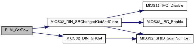

s32 BLM_GetRow ( void   )
This function gets the DIN values of the selected column.
It should be called from the APP_SRIO_ServiceFinish() hook
Returns:
< 0 on errors
