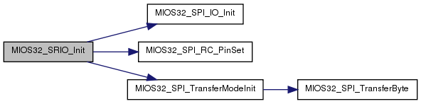

s32 MIOS32_SRIO_Init ( u32  mode  )
Initializes SPI pins and peripheral
Parameters:
[in] mode currently only mode 0 supported
Returns:
< 0 if initialisation failed
