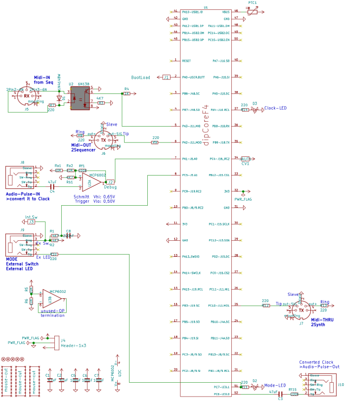

i use a zoom livetrack-l12, a multitrack-audio-recorder: compact design, severell submixes, parametric eqs, compressor, efx and a master-track-recording, a good price…
AND it doesnt have midi… it does not do midiclock.
so when i have to make a track new, or i want to overdub a track, a track that is Midiclock-Driven a sequencer track for example…
So with this device, i lose one Audio-Track, because i use this one Audio-Track, as a Click-Track, it records Audio-Rectangle-Pulses, which are a converted Midiclock-Pulses
when i then playback the Click-Track-Recording, it converts this Audio Pulses back to Midiclock-Messages.
Thats all, not much code, stripped down, running thight.

- convert Midi-Clock-Data to Audio-Pulses
convert Audio-Pulses to Midi-Clock-Data

Shematic
