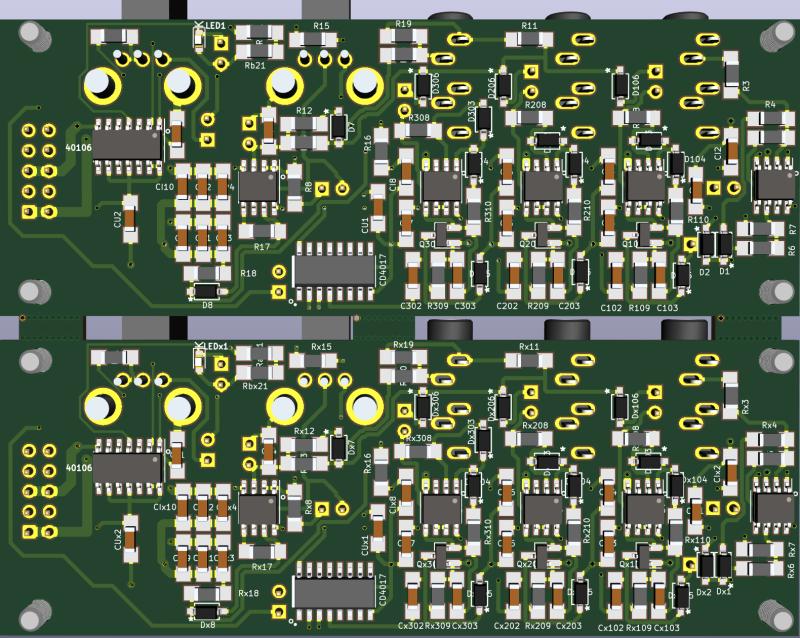

a SMD Variant, ready for Pick and Place
–shown 2 identical boards on one pcb - to save money..

The Design is optimized for Pick and Place most SMD Parts are on the Top-PCB
i ordered 5 PCBs from JLCPCP with almost all SMD Parts presoldered(except 2 SOIC chips PTC and Protection Diode)

the actual Picture is this
