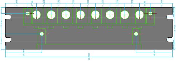

Frontpanel
Recommend Material
2mm x 128.5 x 17.78 Aluminium, anodised
A cheaper way is: order a 1,6mm thick Aluminium PCB as Frontpanel:
I will test this… this are the gerbers:
