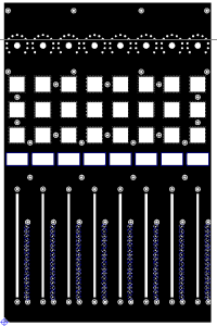

====== Fadercore ====== Fadercore is a Project to make a reproducible and scaleable Fadermodule that can be used for DAW proposals. I started 2010 with that idea because i was Live Engineer of a concert Location. I used a software DAW for mixing because it was the cheapest console on market. Since then Behringer mixed up the market totaly my purposes changes. Now its just a fun Projekt to learn how to design an Electronic Product. The goal of Fadercore is to make a Modul of 8 Faderstrips where every strip has 1 Oled, 3 Buttons and one Encoder and is scaleable up to 32 Faders (4 Modules) The Heart of a Fadercore is a STM32F4Demo or a LPC17Core with a special Header for Display chains... ===== Frontpanel ===== {{:screenshot_2014-06-01_10.09.36.png?200|}} ===== Diagram of System ===== {{:fadercore-blockdiagramm.png?600|}} ===== The follwoing steps are to be done: ===== Make a board that has connections to 32 displays. - done Make a board that has connections to 8 Encoders with LED rings. - done Make a Faderboard that connects 8 Motorized Faders to the Core board. - done but has to be redone for STM32F4Demo Make a board that connects to 24 Buttons and min. 48LEDs if not (RGB) 72LEDs. Make a Frontpanel. - depends on Buttonboard... Make a Case that is scaleable so it is Possible to rise the number of Fadermodules... Make a Demosoftware .NGC file that can be used from Midibox newbies... :-) Make a Board that holds the Matrix for small meters. ' ' ===== More details to the Project Parts: ===== [[fadercore - VLR-8oDisp|VLR-8oDISP]] [[Fadercore - VLR-Motorfader|VLR-Motorfader]] [[Fadercore - VLR-8Enc|VLR-8Enc]] [[Fadercore - VLR-3x8But|VLR-3x8But]] [[Fadercore - VLR-8x16LEDmeter|VLR-8x16LEDmeter]] VLR-Frontpanel VLR-Case So. im now in year 3. Hope i get that baby walk faster soon...
