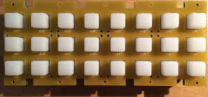

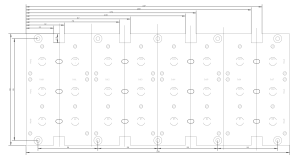

Standard 220mm wide modules
VLR-3x8But
A PCB to add 24 Buttons with RGB LEDs for each.

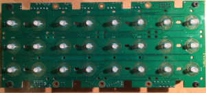

Prepare the PCB
Start with the SMD parts and then go on the the conventional parts also on the Bottom side. Don't forget the R11,12,13. Then go on with the Topside and the LEDs before soldering the Encoder as last. Check the Connections with a Lens.

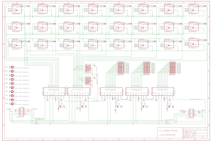

To make it work with MIOS .NGC File we need to know how the shift-registers are connected.
Inputs:
1# Encoder 1-4
2# Encoder 5-8
3# Encoder Button 1-8
Outputs:
1# RED Shaft LED 1-8
2# GREEN shaft LED 1-8
3# BLUE shaft LED 1-8
4# LED Ring Row 1-8
5# LED Ring Selct 1-8
6# LED Ring Select 9-11
Assuming that the VLR-8Enc is the first device on the chain of J8/9 we need to configure it like this:
