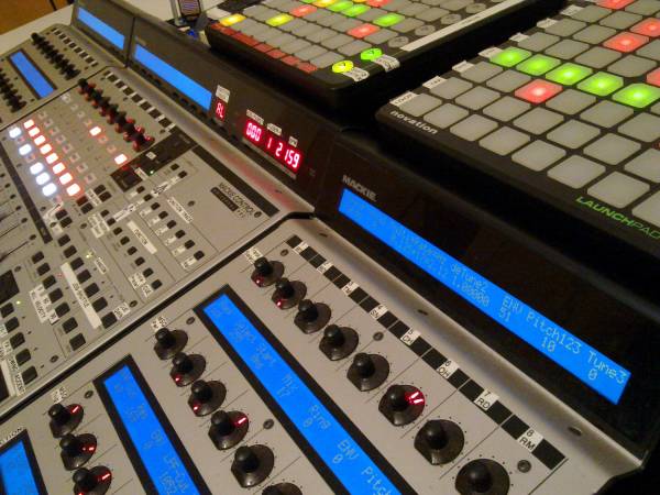

The Idea from Retriggering Melodys and Drums from a more or less static drum-sequence, goes (for me) back into 2010, where i realized it via Max4Live:
Max4Live-Device and 2012 standalone in MAX-MSP, a grown Groovebox was born:
Video-GruftBox-in-use
then comes the 8bit Prototype, built in a Techstar made it a TEKKSTAR, but also there it was soon replaced with a 32Bit Core,
Tekkstar in use
it was a 8×8 LED-Matrix, with 2×8 Buttons, on Breathboard
a other 32bit Variante built in on the Upper-Manual in Crumar 198, UI-controlled via a BCR2000
Video-Crumar-In-Use
