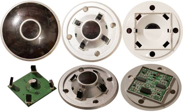

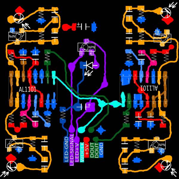

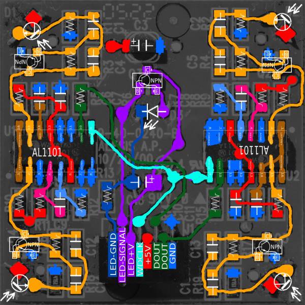

The XYZ Dome works with 1 IR DIODE, and 4 IR Transistors, which are connected to 2x Stereo Audio ADC 24Bit running on Wordclock…
I dont know if i can get the Alesis ADCs running (AL1101) - see Datasheet
al1101-datasheet.pdf
maybe i only remove the DACs and connect them to J5A!
PCB/Shematic
