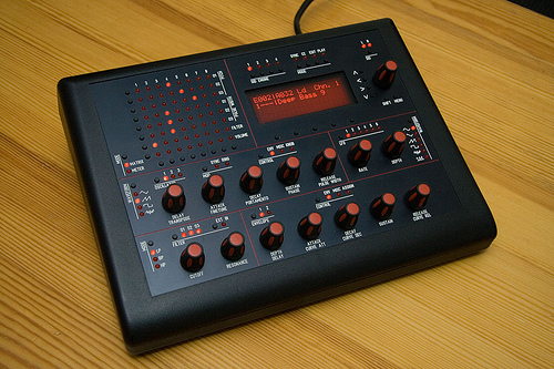

MB-6582 is the name of my MIDIbox SID Synthesizer V2 project.
When it was finished, I was totally surprised that it was making appearances on many blogs, but what surprised me the most was when it appeared on Hack-a-day:
“This is one of the nicest DIY builds I've seen in a while - just beautiful work.” - Will O'Brian, Hack-a-day
However, this one was the most amusing:
“Sometimes you see a DIY project and you're just like “are you fucking kidding me? This is one such, for sure. This dude's MIDIbox SID is a DIY synth the way that an Aston Martin Vanquish is a car. I mean, like, fuck. Eight (as in “the number after seven”) 6582 SID chips for four stereo (as in “mono times two”) channels of audio, a nice FPE panel, and the same number of LEDs as any random sign in Times Square.” - Chris Randall, Analog Industries
But my favourite bit of praise:
It's pure eye candy - not only outside, but also inside the case - TK's comment from MIDIbox of the Week
Well, there was my fifteen minutes… :)
I've received lots of praise for the design, but what I'm still amazed about is that so many people want one just like this. While designing it, I only catered for my needs, but still considered what might be useful for the few crazy SID fans who might want just the base PCB to upgrade their current MIDIbox SID to the new maximum of 8 SIDs. There are some people following this upgrade path, like TK and MTE, but with so many other people wanting one too, I decided it would be best if I did a few changes to suit everybody's needs.
The rest of this wiki page is thus relevant to people who bought or will buy the revised PCBs, whether just using the base PCB (with the PICs and SIDs on it) or the control surface PCB (with the switches, LEDs and rotary encoders).
