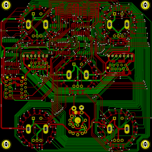

* 5 Encoders
* 5 Ledrings
* 5 ENC-Switchs
* 5 3LEDS for ENC-Switches
* 1 Shift-Switch
* 2 1306 7Pin- OLED-LCDs
controlled from a STM32F4 Microcontroller dipcoref4,CV1
build for CV1 as UI-Expansion-PCB.
ready for Pick and Place

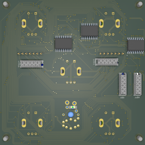

–all Parts except the ULN-Driver-ICs are on the Top-Side, and are presoldered..

The Design is optimized for Pick and Place > allmost all SMD Parts are on the Top-PCB
The Rest is Thruhole > easy, the ULN Driver are SMD and has to be handsolderd
now waiting for Presoldered PCBs
